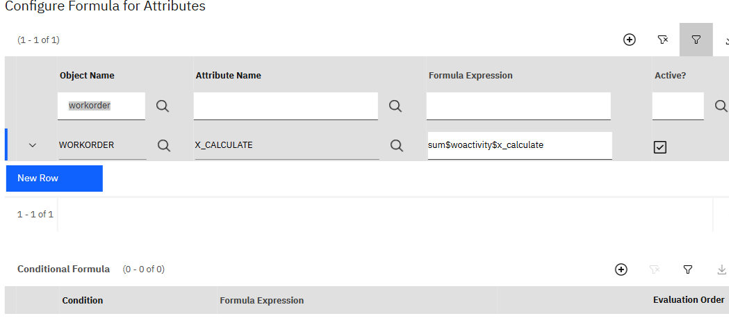

Thank you for responding. I checked the logs and found that something like, FormulaMBoEventlistner event maximo.workorder.add has been fired for object Workorder launch point x_calculate .
i found there is no autoscript as such  but there is an attribute formula for workorder object sum$woactivity$x_calculate
I am not able to figure out what might be causing this issue, because the same set up is in lower environment and i am mot getting error there
Do you have any conditions on the formula? It'd be displayed underneath the formula in the Conditional Formula section.
I've tested creating a new attribute called x_calculate on the WORKORDER object (which would add it to the underlying views like WOACTIVITY) and adding your exact formula to this attribute. Even when I mix and match null and non-null values on the child object, and whether I pick a work order with or without tasks, I can't trigger the null pointer exception. It's possible you're on a version with a defect or it's possible you have some additional configuration that is required to trigger the null pointer exception. I've seen this in formulas a lot, especially with formulas that manipulate dates where people don't validate that the attribute is not null before trying to perform a function against it.
