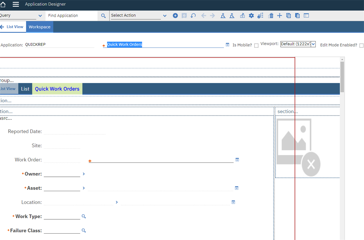

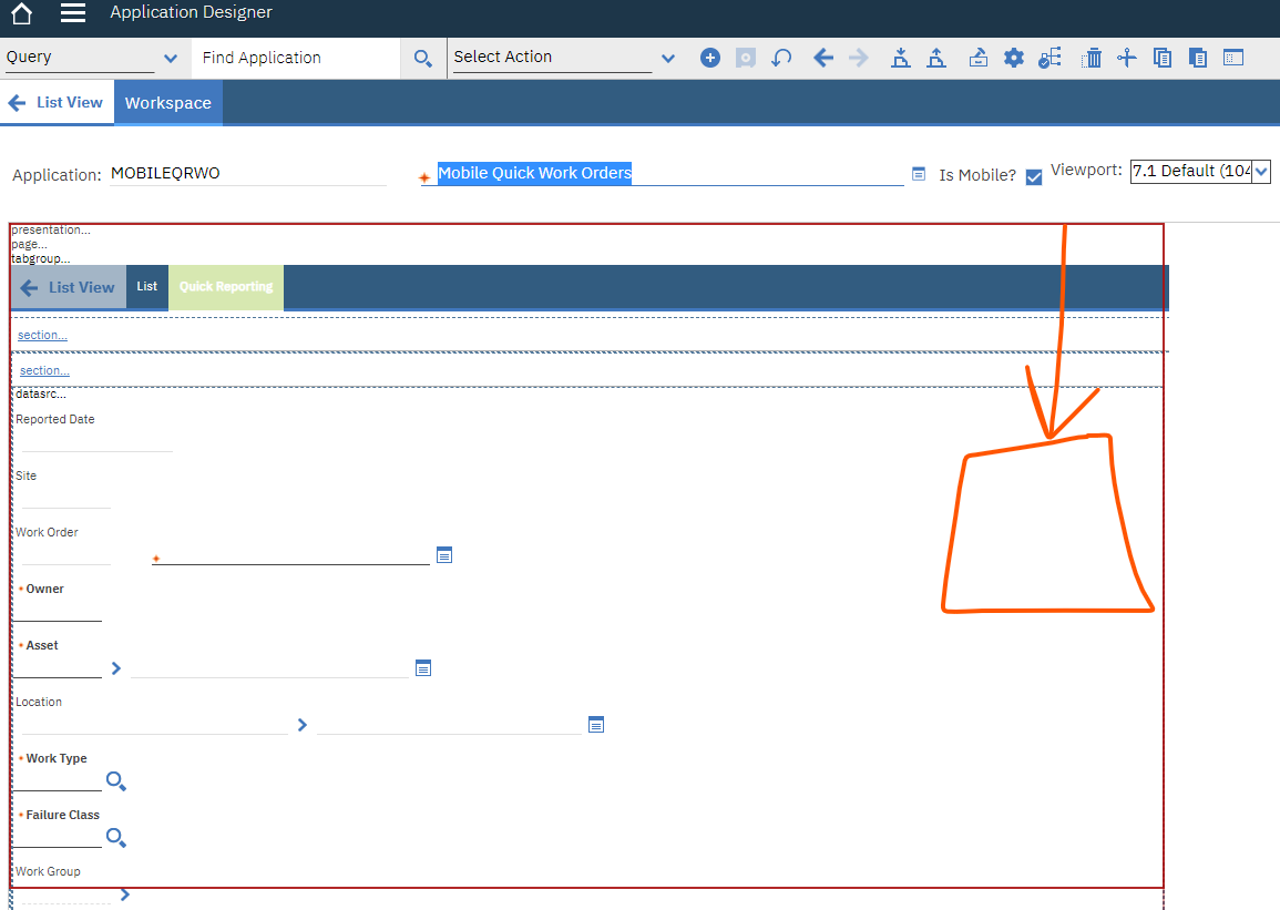

Hello all,
I'm trying to add a section to the right of this section so that I can add a picture of the asset for QWO.  I must have accidentally done it before because I can't get it to work this second time.  Sections always add on top of or below other sections, but they won't add to the side to widen the page.  Any suggestions?
Thank you in advance.

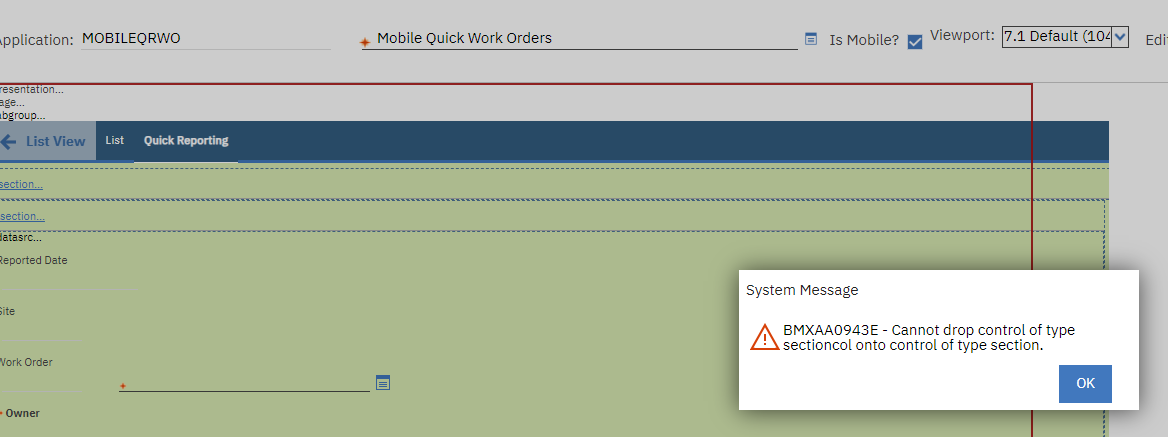

Thank you @Subhransu Sekhar Sahoo for your response.  I tried adding a Section Column but am getting this error or similar no matter where I place it.
Please advise, Thank you.
Christopher Winston's profile image
Christopher Winston
It is hard to tell from the screenshot and I don't recognize the application, but it looks like you are in a section and you need to be in a column.
So, add a Section Column, then a Section in the new Section Column (so, to the right) and then add your element to the new Section.

Vivek Nagre's profile image
Vivek Nagre
Hi @Danny Richardson if my understanding is correct like you want two sections over there one contains the field and the other containing the image if so you have to take  one section first then  inside that you have to take the section row and inside that you have to take two section Colom on col contain fields and one section contains the image.
