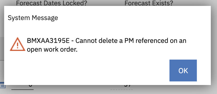

Prashant Sharma
Hi - If PM has Open Work Order issued on it, you can't delete it. The system will not allow you to delete it. When you try it, you will get this error-
Ideally you should not be deleting the PM as it will for sure impact your history. Always recommended to change status to INACTIVE.
