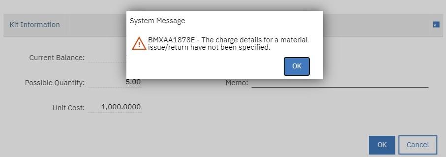

Would anyone know why we are getting this error when trying to issue the kit?  GL Account is correct and not sure where else to look to fix the issue.
Trying to create a kit for the Purchasing Department
Version 7.6.2

HI Danny,
Please check both GL Debit and Credit account is populated.

Hi Danny,
In which application in Maximo, you are trying to issue the item?
From Inventory --> Issue Current Item  or  Inventory Usage ?
If Inventory --> Issue Current Item , then the GL debit account should be present in the Issue Current Item Dialog box. Please check whether it is blank or having value. GL Credit Account doesn't matter in this case.
