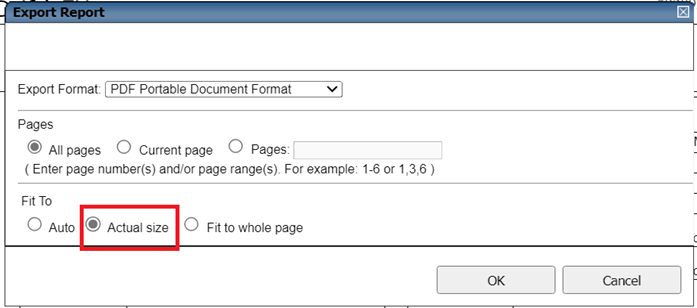

"Work order detail" report for some work orders goes in an infinite download when exported with "Auto" fit size.
However, when I change the fit to "Actual" from the default "Auto", the report seems to be downloading just fine.
When a user clicks on the print button directly from the toolbar, it goes on a loop. By default, it is printed with "Auto" fit (my assumption), as a workaround, is there any way to change this to "Actual"?

You'll need to edit the HTML file. Specifically you'll need to find the following DIV ID "exportFitSetting". In this DIV you'll see the three input types, exportFitToAuto has a value of "CHECKED" remove that and add to exportFitToActual.
