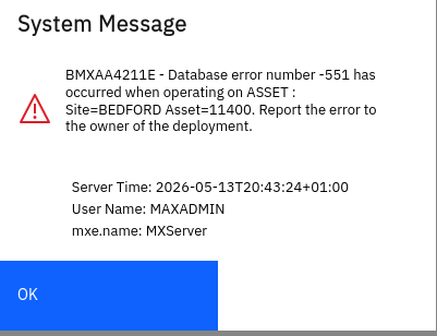

The above lets me log in successfully and when i go to a record I can open it like normal (tested several Assets, Work Orders, Locations etc) and if I try and update it as we expect I get the following error
