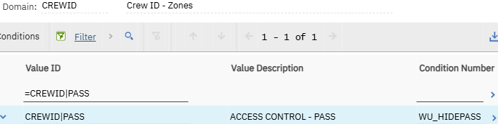

Hi Jessica,  Unfortunately this did not work for me.  Could it be that I am trying to do this with the CREWID domain on work orders?

I used this condition: exists(select 1 from groupuser where userid=:USER and groupname='LOCK') and called it "WU_HIDEPASS".  I then associated this condition with a crewid value called PASS in the domain.
