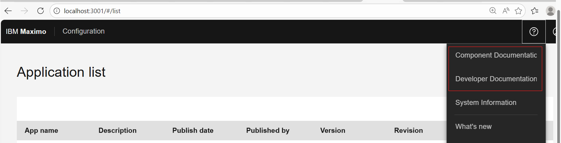

Hi ,
While accessing documentation in MAF tool, getting error message.
Error: ENOENT: no such file or directory, stat '/graphite/packages/config-server/client/docs/maximo-app-framework/graphite-documentation/public/index.html'
I can see there is no following folder structure exists /maximo-app-framework/graphite-documentation/public/index.html .
Please help to fix this.
Thanks & Regards
Since you're running this locally, I assume you're on 9.0 or an earlier version. Can you share what specific version (IE 9.0.17-amd64) of the MAF tools you are using? It's possible there was an issue on a specific version. It is important you match the version here for your specific Maximo version: Configuring and customizing IBM® Maximo® Mobile
JustIn goodLuck's profile image
JustIn goodLuck
Hi @Steven Shull
We have   below details.
IBM Maximo Mobile 9.0.174 Build 20250810-1201 DB Build V9000-74 HFDB Build HF9000-40
Maximo Application Framework 9.0.174 Build 20250808-1801 DB Build V7600-36 HFD
Maximo Manage 9.0.174 Build 20250813-1325 DB Build V9000-01 HFDB Build HF900
IBM Image: -   9.0.17-amd64
Previously in lower version, that documentation was accessible but now not.
It looks like this is a known issue on 9.0.17, 9.0.18, and 9.0.20 Known Issue: DT463289
You must build with this version of the app, but you'll need to use a different version of the app to review the documentation.
