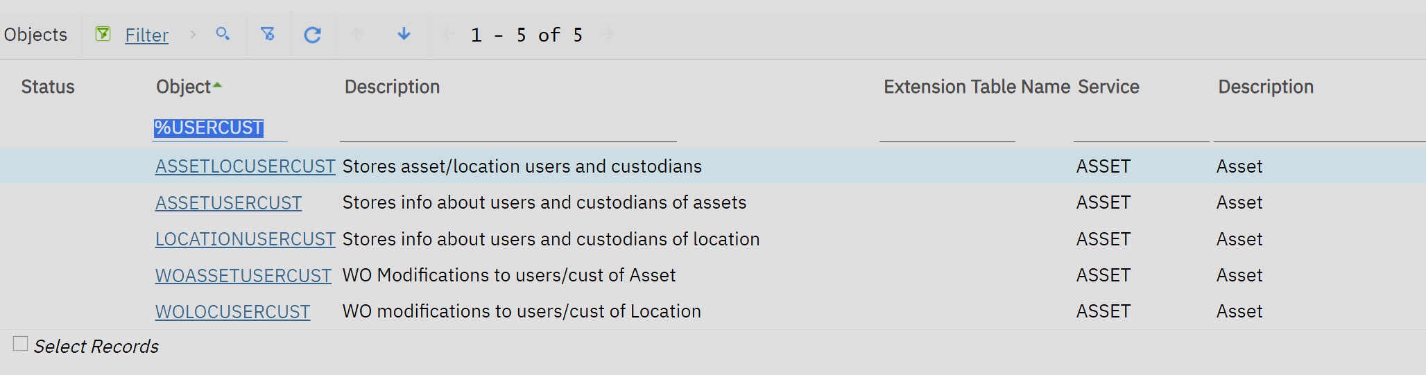

Your question is profound. The underlying context in your question is a reality check. The simple answer to your question is that data does not exist in Maximo by design. The query below contains the criteria used to create the LOCATIONUSERCUST. There is no data available in Maximo to meet the minimum criteria of your profound question.
SELECT * FROM ASSET WHERE location is not null and assetnum IN (SELECT ASSETNUM FROM assetlocusercust WHERE LOCATION IS NOT NULL AND addperson=0)

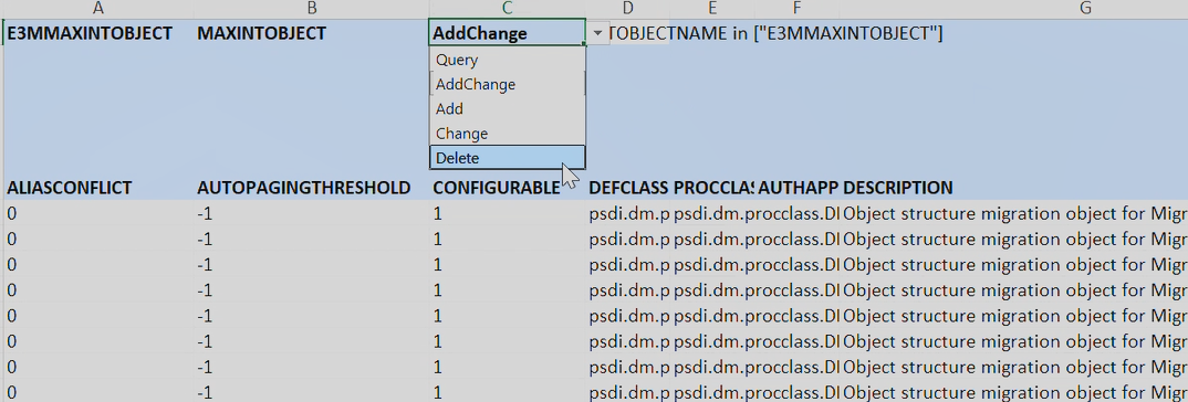

MxLoader Capabilities Hidden in Your Question:
Bruno Portaluri, the visionary creator of MxLoader, developed the tool when data loading was the primary use case and REST API capabilities were in their infancy. Today's Maximo REST API offers comprehensive CRUD operations, enhanced authentication via API keys, robust validation enforcement, and standardized audit logging. The modern REST API architecture incorporates security controls and governance frameworks that reflect contemporary data governance requirements—capabilities that predate MxLoader's original design paradigm.
Bruno Portaluri released MxLoader in May 2014, as announced in his official blog post on May 15, 2014. His vision in designing MxLoader placed him more than a decade ahead of industry trends. Initially conceived as a tool for data loading operations, MxLoader operates through Object Structures, providing full CRUD (Create, Read, Update, Delete) capabilities. The reality your question mandates is that the times have caught up to Bruno's vision, more than a decade later.
To answer your question: Yes, deleting records via MxLoader is technically possible. Object Structures can be configured to support DELETE operations, and MxLoader can execute those deletions. However, this technical capability exists in tension with enterprise data governance principles, compliance mandates, and the embedded security controls that distinguish Maximo as an enterprise-grade asset management solution.

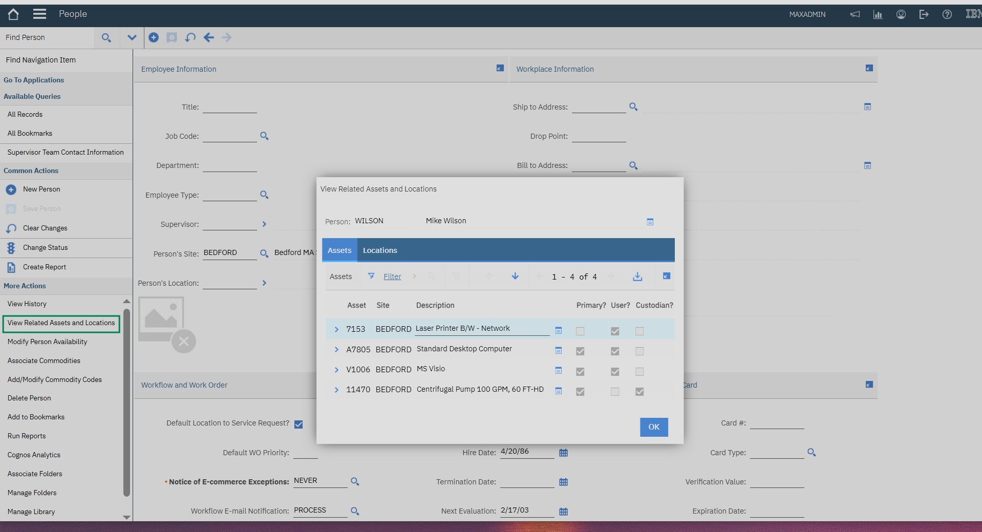

Viewing Associations:
From the People application, you can use the "View Related Assets and Locations" action to view all assets and locations where a person is designated as a user or custodian. This is particularly useful when someone changes roles or leaves the organization.

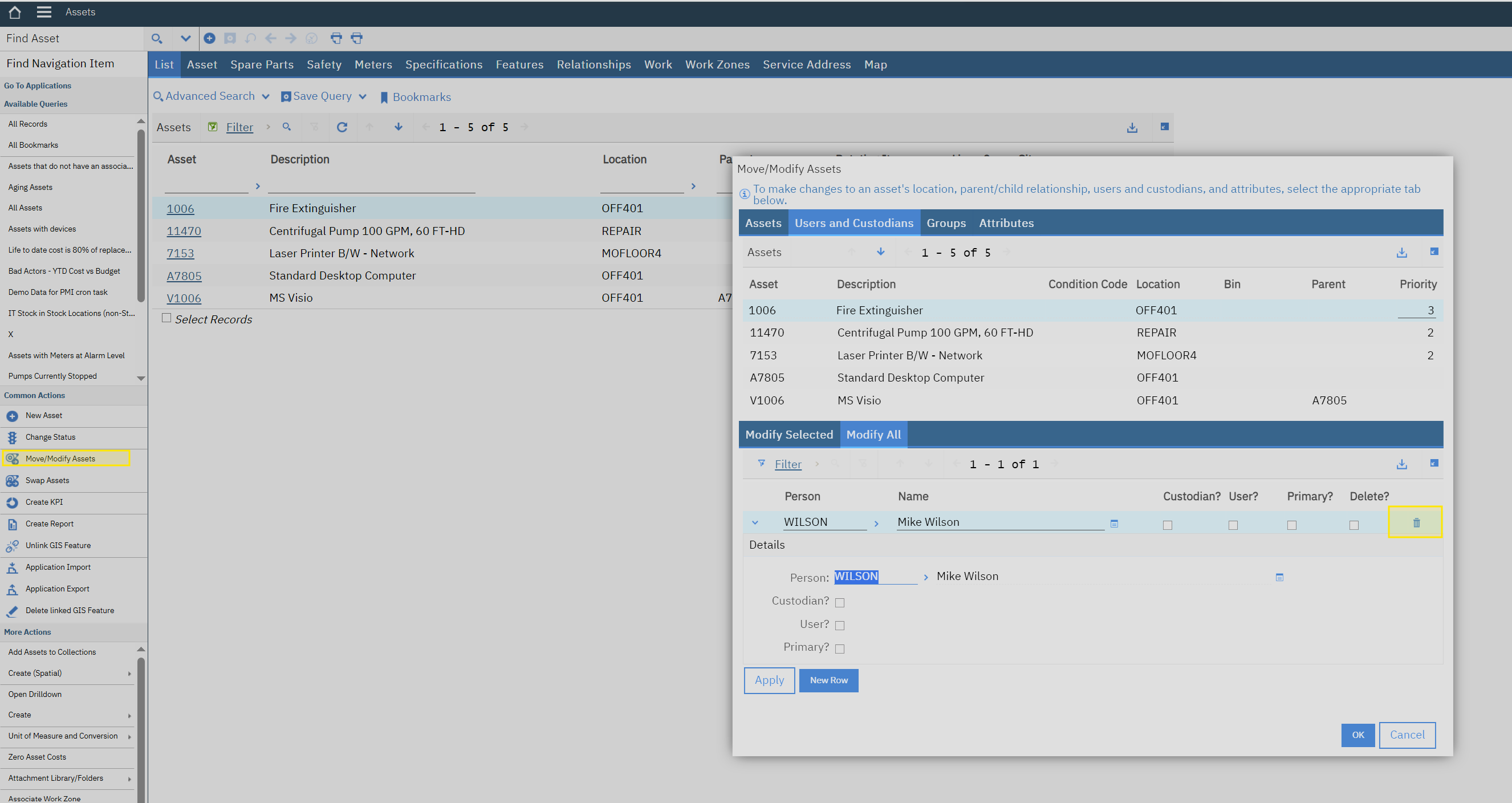

Bulk Modifications:
In the Assets application, the Move/Modify Assets action allows you to change users and custodians for multiple assets simultaneously through the Users and Custodians tab. This operates on selected asset sets with two options:​
  •  Modify Selected: Make different changes to each selected asset individually
  • Modify All: Apply the same change to all selected assets

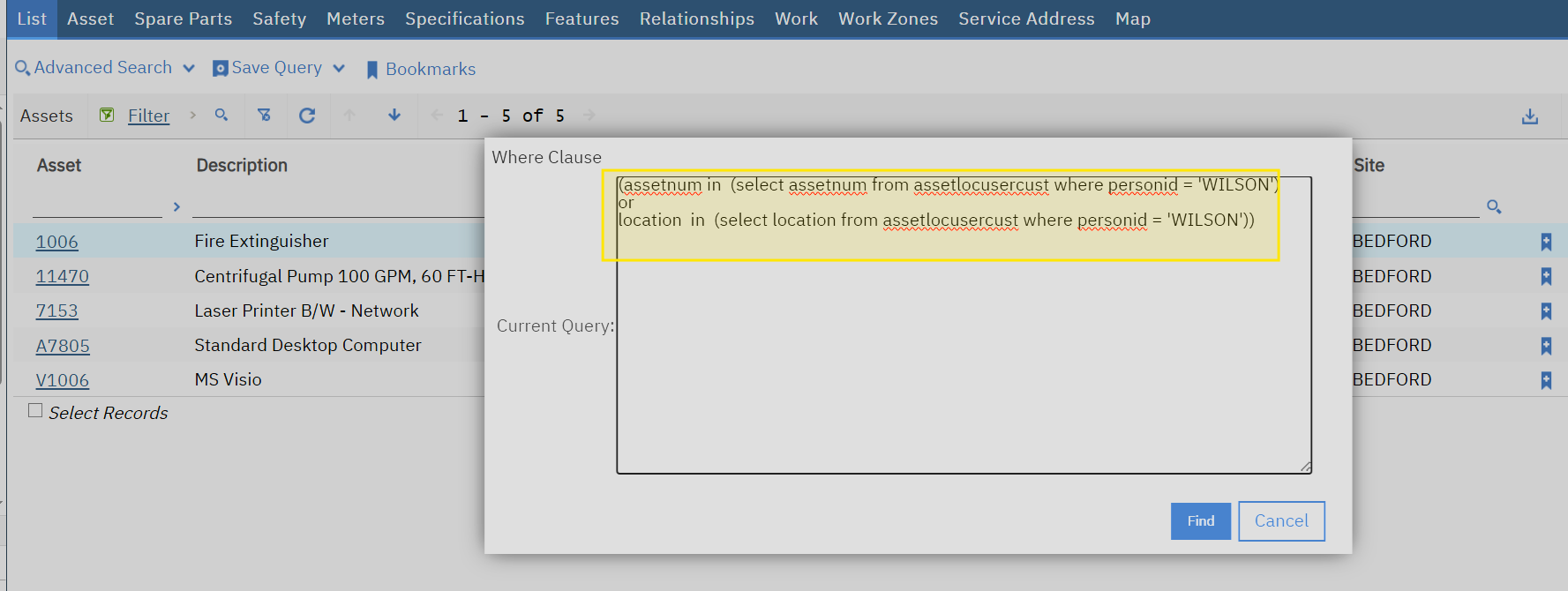

If your use case is related to a single user:
1. First, identify all assets and locations where the user is designated as a user or custodian
2. Use the where clause below to identify all asset and location records related to a person or multiple people using the where clause below:
(assetnum in  (select assetnum from assetlocusercust where personid = 'WILSON')
or
location  in  (select location from assetlocusercust where personid = 'WILSON'))
3.  Then, apply the same to all assets and locations identified in step 1.
