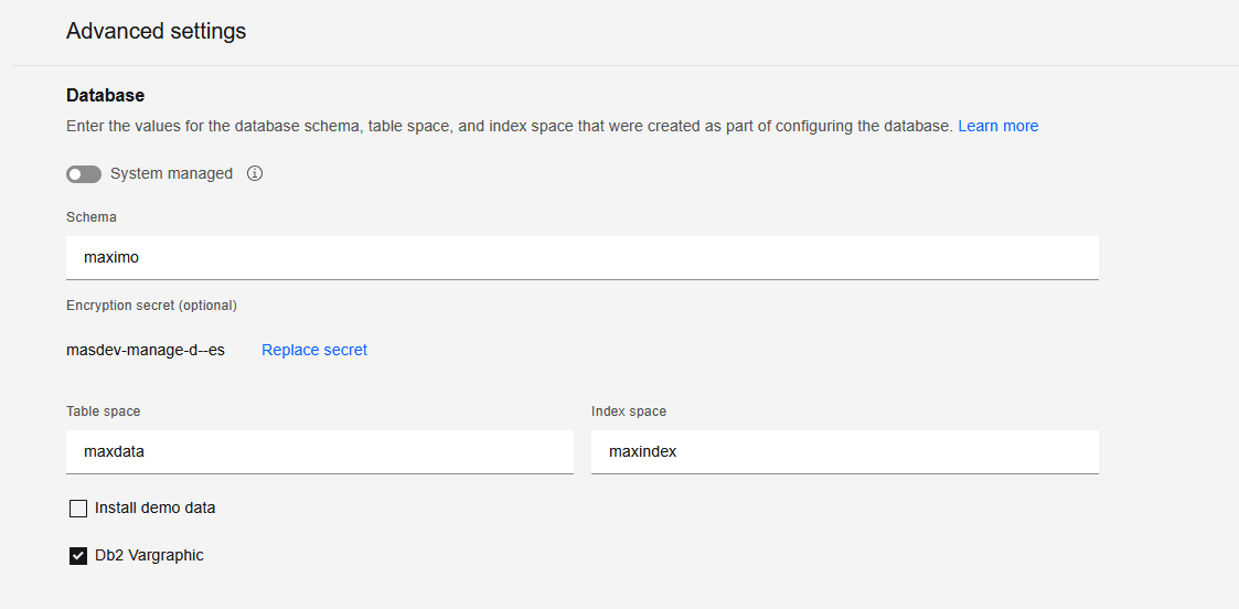

Hi Andrew,
You can change it in the MAS Admin UI in Manage workspace > update configuration > Advanced settings > Database configuration as shown in the image below.
Hope it helps
Regards
Andrew Meuse's profile image
Andrew Meuse
That is where I've done it after Manage is installed. I had a failed Manage install, deleted the Manage Namespace, kept Core and was looking to change those values before trying the Manage install again.
