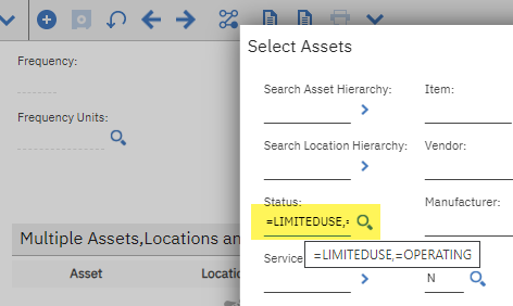

    In WOTRACK app > Multiple Assets, Locations and CIs section > click "Select" button > Assets > Select Value > "Select Assets" form, Status field has default value of OPERATING (see print screen below).
    They asked to have by default multiple statuses, something like "=LIMITEDUSE,=OPERATING" (see print screen below).

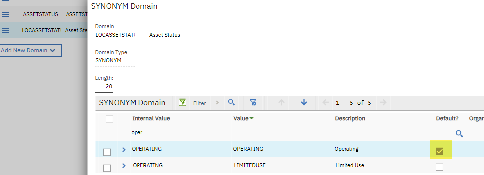

    However, I noticed that in Domain LOCASSETSTATUS, OPERATING is the default synonym value (of Internal Value OPERATING).
    If I change de default value to something else (e.g. LIMITEDUSE) then the default value which is appearing in the Status field on "Select Asset" form mentioned above is LIMITEDUSE.
