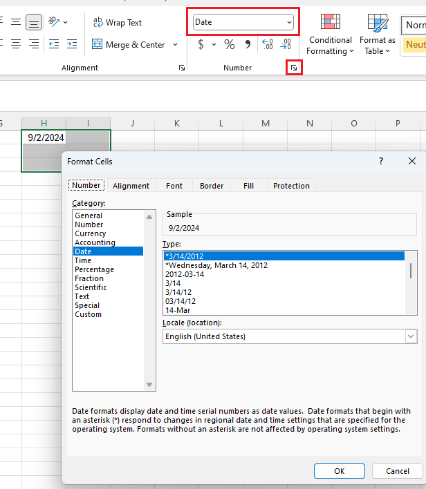

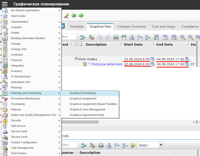

How do you export the records to excel? The process you use is what is complicating the visualization. You will have to analyze this process to be able to correct it.
Try to query it with a database client and export it to excel. Or use the "export to" process from IBM Maximo (from application ). Also, check if it is not possible to simply export the records. I see that the problem is with "Star Date" and "End Date" and then, you can try to add these 2 data as columns in list mode and export the records you need (you will not have problems that way).
