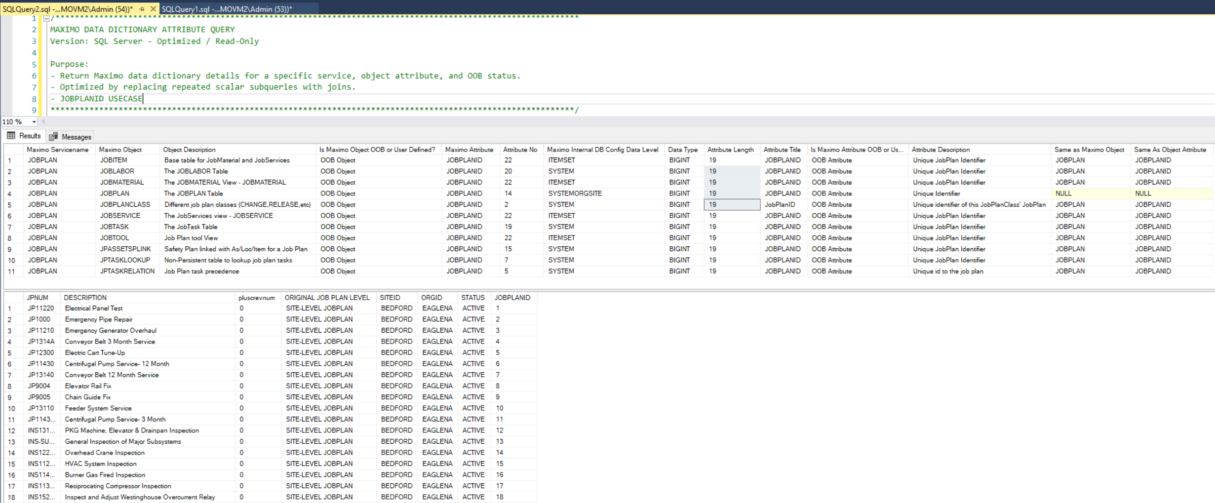

    I created the SQL Server Query below as a tool to fetch the Job-Plan-Related data needed to understand your unique use case.
    1. Query No.1: MAXIMO DATA DICTIONARY ATTRIBUTE QUERY -  Use this query to identify the related Job Plan records. OOB, the Job Plan's Unique ID is the JOBPLANID. OOB, Maximo uses the SAMEASOBJECT and SAMEASATTRIBUTE for validation.
    2. Query No.2: QUERY TO IDENTIFY JOB PLAN MAXIMO INTERNAL DB CONFIG SETORGSITE FOR UNIQUE JOB PLAN RECORDS - Use this query to identify the internal Maximo record site-orgType: System, Set, Organization, or Site Level.
    Please see a screenshot of the Max Demo Database SQL Server example below:
