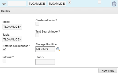

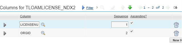

    I sent my log to IBM and they identified it.  It looks to me like your error is slightly different because of the Primary Key information in there.  Have you recently added any object structures or custom objects?  It sounds like there is an object missing a valid primary/index or key.  Following are the notes from my case:
    TLOAMLICENSE is part of Control Desk. On the object in Database Configuration, it looks like it is set to use the TLOAMLICENSE_NDX2 but we're unable to find it to determine which columns to look at. This will break the entire cache for object structures (breaking integrations, mobile, work centers, etc.).
    They should open the TLOAMLICENSE object in Database Configuration, then switch to the Indexes tab in Database Configuration. Add the following index if it does not exist.
    IMPORTANT: Before running the DB Config, they should verify they have not violated the unique index rule in the database. They should run the following query:
    select licensenum,orgid from tloamlicense group by licensenum,orgid having count(1)>1;
    Index: TLOAMLICENSE_NDX2
    Enforce Uniqueness: Enabled
    Columns
    LICENSENUM
                    Sequence: 1
                    Ascending: Enabled
    ORGID
                    Sequence 2
                    Ascending: Enabled

    This seems to be the same Object Structure cache error from your earlier log. The APPLICATIONAUTH query is Maximo rebuilding the MAXADMIN security profile following the security change. During that process, Maximo attempts to load the Object Structure cache and encounters the null primary-key information.
    I do not think the READ grant itself created the primary-key problem; it appears to have triggered the process that exposed it. Unfortunately, this stack trace still does not identify the offending object or object structure.
    In my case, the missing index was identified while troubleshooting my environment, but the affected object in your environment may be entirely different. I recommend opening an IBM Support case and asking them to identify which object Maximo is processing when MosDetailInfo.setAltKeys() fails. They should also check for an object included in an Object Structure that has missing or inconsistent primary/unique index metadata. Comparing Database Configuration and Object Structure metadata with a working environment may help narrow it down.
    This part of your stack trace points to the same issue:
    ObjectStructureCacheImpl.loadMosDetails
    BMXAA7733E - There was an error loading the Object Structure cache
    According to Google:
    The error BMXAA7733E - There was an error loading the Object Structure cache indicates a data dictionary inconsistency within your IBM Maximo / Maximo Application Suite (MAS) database. It explicitly occurs when Maximo's integration or OSLC cache attempts to load metadata for an Object Structure, but references a database object, index, or column that either no longer exists or mismatch in configuration. [1, 2, 3]
