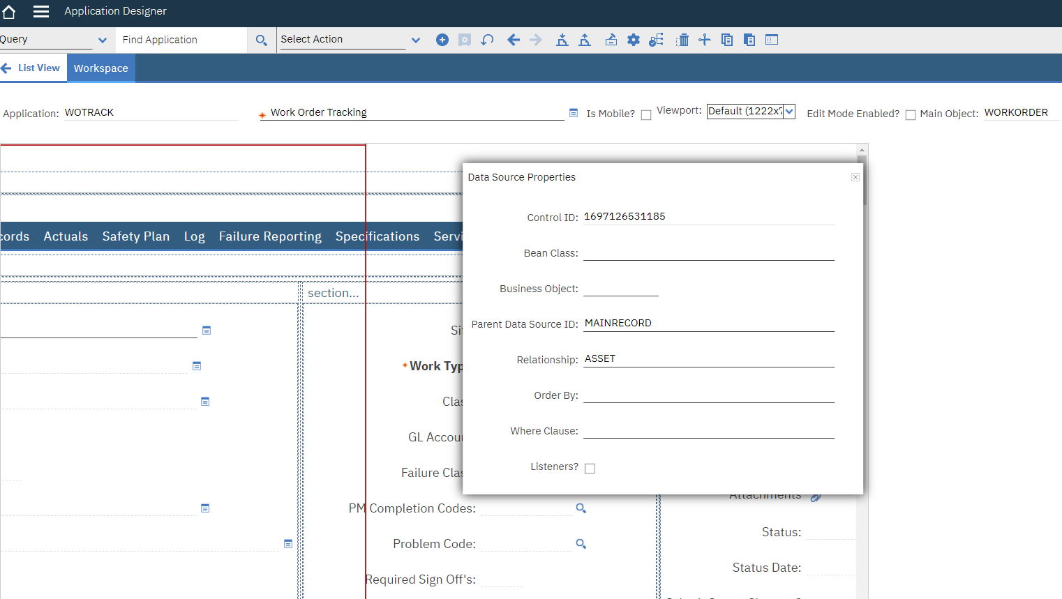

    Is it possible to add a second picture to Assets?
    For example:  We would like 1 picture to be the Asset, but a 2nd picture to be the part produced.
    I think I can add a stand alone image and upload the file, but I would like to know if I can reference that second image in WOTRACK and QUICKREP.  The Data Source for the image there currently has a Parent Data Source ID:  MAINRECORD.
    So I'm not sure how to reference this second image, so that it pulls automatically on the Work Order.

    Have you tried attachments?  Those should show on the Work Order (or almost anywhere else the asset is used) if you tell it to show.
