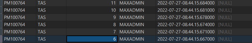

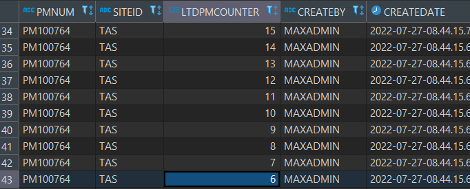

    Posted 07-26-2022 19:28
    Hi Keith,
    As I started my reply as a confused person, I had an ah-hah moment.
    Firstly, can you reduce my confusion around your statement "that does not depend on periodic frequency".  An example would be great.
    My ah-hah moment was reflecting on the solution I have given where the PM counter is reset after reaching the max(sequence).  This does not assist with the forecast so that it matches.  I haven't looked into how the forecasting can be altered to also 'reset' the counter.  Well I did just look and hopefully, it should be the LTDPMCOUNT field in the PMFORECASTJP object
