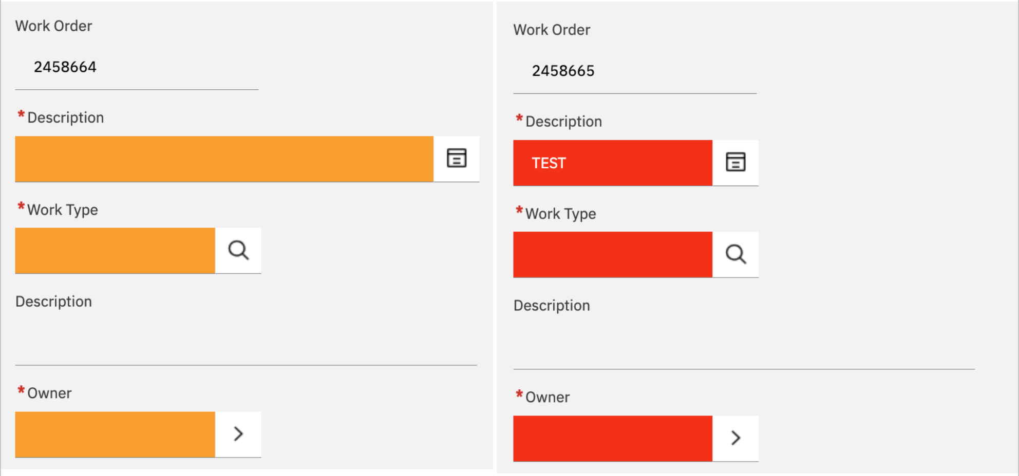

    I wanted to have white input text for a red background required field and used the value:  bgred" style="color: #ffffff !important;
    This works except that due to the new Carbon Design system it is causing it not to respect the custom CTRL_TEXTBOX.SIZE.
    Is there a way to still use this bgred" style="color: #ffffff !important; to get the white input text but also enforce the custom CTRL_TEXTBOX.SIZE value that is set?
    On the left is the length that the Description field should be, on the right is what happens when I add the !important; to the CSS.
    Thank you in advance

    Since you mentioned application designer, I assume you're doing conditional UI to adjust the CSS. Can you set the cssclass to bgred txtwhite
    When I did that in my demo system it shows how you want while still keeping the size (I resized this to 20)

    Thank you @Steven Shull.  bgred txtwhite worked.
