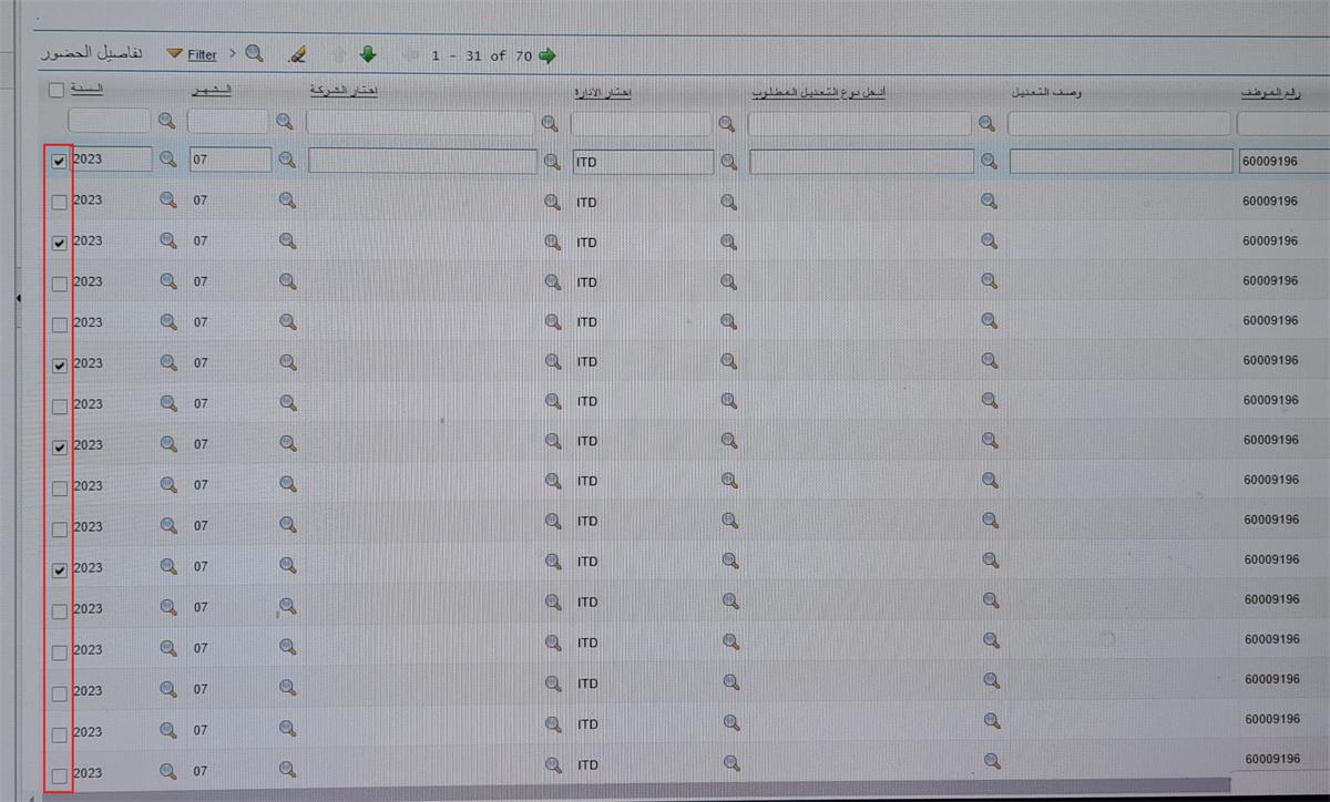

    Hello all,
    As the above picture there is a table control containing data Some records are selected through the check box which is represent the "ID" record.
    The question is how do I know in the automation script which data record is selected ?
    Thanks in advance
    Mohammad Moula
    eSolution
  • 2.  RE: Table Control and Selected Records determination ???
    Posted 06-07-2023 10:05
    You need to do something like this-
    selection = mboSet.getSelection()
    it = selection.iterator()
    while(ir.hasNext())
        selected = i.next()
        id = selected.getUniqueIDValue()
