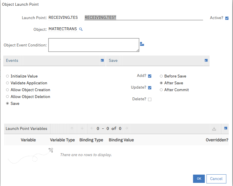

    I am trying to build an IBM Maximo Automation Script that executes after the user clicks "Save" in the Recieving (Receipts) Application.

    current code for Automation Script with Object Launch Point and Object Launch Point Settings
    Settings for Object Launch Point are attached in the photo.
    Logic and thought process for code:
    in the application designer for the Receiving (Receipts) Application, it says the main object is a PO
    However, I am not changing/updating any data related to the po, what I am adding/updating are matrectrans records that are in the table in the Material Recipets Tab in the Receiving Application. (At least i think this is the case)

    You're trying to query columns on POLINE & MATRECTRANS that are non-persistent which is resulting in an invalid query. WONUM is an attribute on those tables but is non-persistent. The persistent attribute is REFWO, but it is important to understand that REFWO will contain the WONUM for the overall workorder or the task if it's at the task level.
    I would also be cautious of doing this process during the receipt because the WO costs will be updated and you'll likely hit an updated by another user error. I would try and build on top of the existing attributes like DIRISSUEMTLSTATUS
