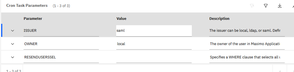

    Posted 06-04-2026 05:49
    Hi Steve,
    I tried by setting parameter values against MASUSERSYNC cron as in above screenshot, but still am having the same issue.
    Chidambar Shastry
    Xyz
  • 4.  RE: User Sync Authentication type issue from Manage to Suite with Rest API
    Posted 06-04-2026 09:32
    Are you saying your cron task had these parameters already, has the exact same parameter values, and new users (not existing) are being pushed in with local authentication? I have never seen that. When these aren't provided it uses the upgrade method to determine but otherwise should use this. It is case sensitive so make sure you have the values all lowercase.
    I'd say you could open a support ticket with IBM but 8.7 has hit end of mainstream support so you may not get a response if you haven't purchased extended support.
