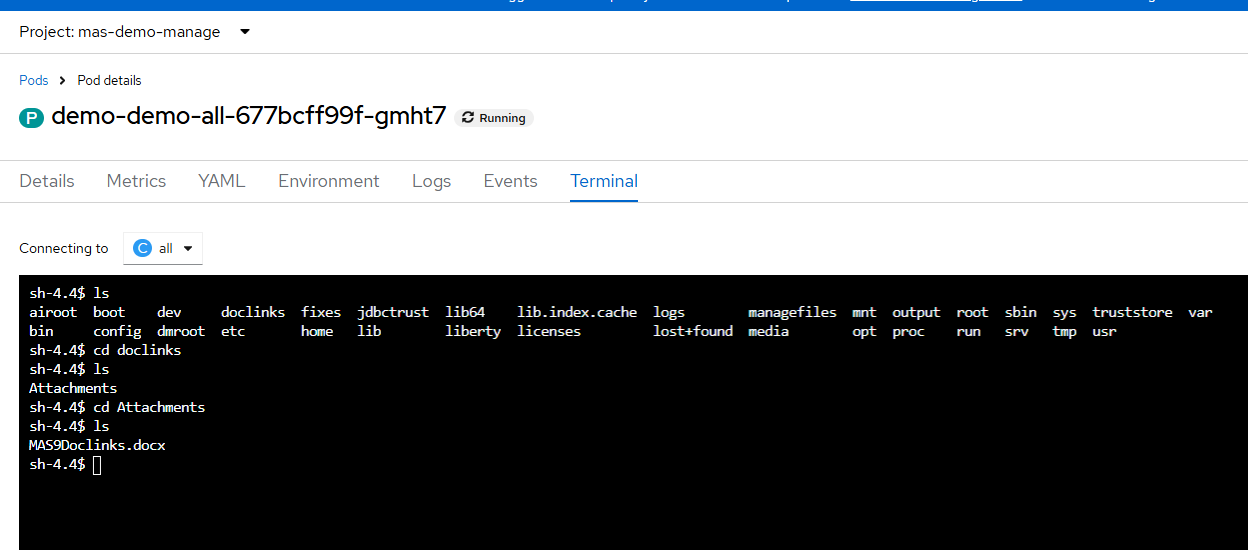

We are running a SNO cluster with doclinks pointing to /doclinks NFS PVC.All of that is working fine and when at the pod terminal I can see the file I added sitting there.I also configured the relevant system properties and in Assets I added a file and it created the file in the pod

/doclinks=https://demo.manage.demo.apps.sno-cluster.*************/doclinks however on retreival I get a liberty webserver error .If I do the mxe.doclink.securedAttachment and mxe.doclink.securedAttachmentDebug true then the file is served but we really want the non secure meaning the https server serving the document wondering if anyone knows what to do
URL executed https://demo.manage.demo.apps.sno-cluster.**************/doclinks/Attachments/MAS9Doclinks.docx our domain masked
