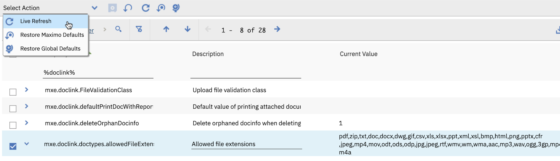

Yes, you can do attachment and download the file. To do this Go to System Properties > Search for mxe.doclink.doctypes.allowedFileExtensions
Now in global value field add  ,stp (it is comma stp) in last of existing value and Save.
Select the checkbox in front of property and go Live Refresh.

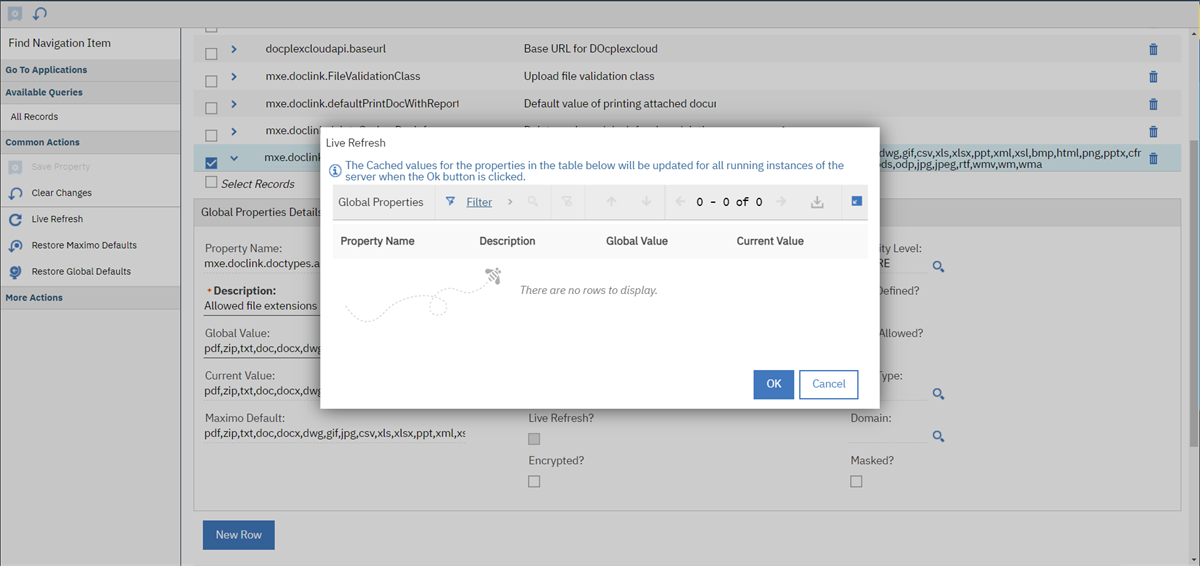

Danny Richardson's profile image
@Prashant Sharma Thank you.  I was able to add the extension in the "Global Value" field.  After selecting the check box and then clicking on Live Refresh it is not working.  It comes up blank.  Any suggestions?  Thank you
