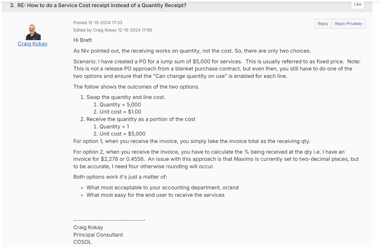

You mentioned that you would like to receive 1,000 out of 10,000, but that you would have to calculate the quantity to be 0.1 (as Maximo would not do that).  Again, not an issue, but you may want to consider 'swapping' the qty and the unit cost around.  This way you enter a qty of 10,000 and a unit cost of $1.00.  This can make accountants do their head in, but it's a simple solution when you do a receipt.

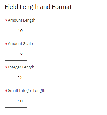

As for the decimal places, that's easy solved.  In Database Configuration there is a Field Length and Format option, which you can change the scale to 3 or even 4.  Just make sure before you run this configuration that you have a good backup.

Hi Craig,
Thanks for the detailed reply. For swapping, it seems that from the beginning, on the PR/PO, the quantity will have to be kept like you mentioned and the Unit Cost will always be $1.
Only then we'll be able to achieve the goal. Kindly confirm.
Shahid
