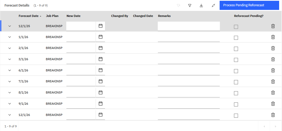

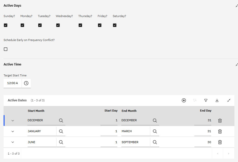

  • 6.  RE: Pausing PM Schedules
    Posted 11-17-2025 16:30
    Making use of Seasonal Dates-> Active Dates could be one way if it matches the business. A quick example as above. Generate a forecast and observe that PM is not set to generate for the inactive months
    Niv Geo
