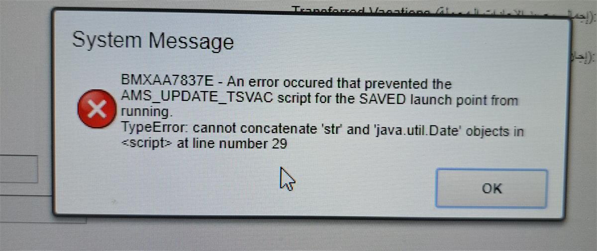

    I have an automation script based on Object lanuch point "ZZAMSVACTRANS" object. While "ZZAMSVACTRANS" has a relationship with "ZZAMSTIMECARD" object through a named relation "VACSHEET". Now I want to get two attributes from current object "ZZAMSVACTRANS" which are a string attribute ( "ZZEMPLOYEENO")  & a date attribute ("VACATION_START") . Next I want to search for those two fields in "VACTIMESHEET" as follow:
    from psdi.server import MXServer
    from psdi.mbo import SqlFormat
    from psdi.mbo import MboValue
    mVac = mbo.getTisMboSet()
    mTS = mbo.getMboSet("VACTIMESHEET")
    mEmpno = mVac.getString("ZZEMPLOYEENO")
    mVacstart = mVac.getDate("VACATION_START")
    ** Next setWhere works fine but to search for only the string attribute
    mTS.setWhere("ZZEMPLOYEENO="+mEpno)
    ** Next setWhere does not work ???
    mTS.setWhere("TS_DAY="+mVacstart)
    I got thise error as in the picture
    So, I need one setWhere to find both mEmpno and mVacstart as the following if possible:
    mTS.setWhere("ZZEMPLOYEENO="+mEmpno + " and TS_DAY="+mVacstart)
    any help , thanks in advance

    You need to use SQLFORMAT class.
    sqlf = SqlFormat("ZZEMPLOYEENO = :1 and TS_DAY = :2")
    sqlf.setObject(1,"ASSETMETER", "ZZEMPLOYEENO", mEpno)
    sqlf.setObject(2,"ASSETMETER", "TS_DAY", mEpno)
    mTS.setWhere(sqlf.format())
