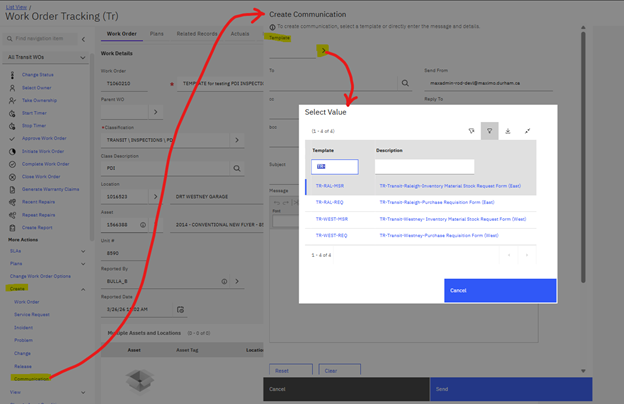

I'm trying to automatically filter down a list displayed to the users when they create a new Communication on a Work Order.  I am trying this with an Automation Script, but no luck yet.  Here is what I am doing:
1.      Go to Work Order Tracking (Tr) application
2.      Under Actions, select Create – Communication
3.      On the Create Communication dialog, click on the chevron beside “Template” and choose “Select Value”
4.      Here we need to filter the list to only show Templates for “Transit” users.  (ie. LIKE “TR-%”)
A screenshot of a computer
AI-generated content may be incorrect.

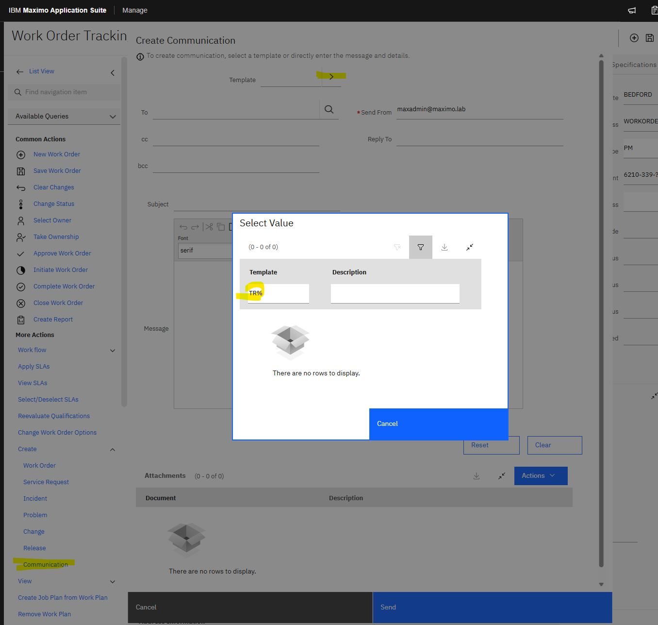

Initially the list shown has about 34 Templates to choose from, but the users needs to type “TR-“ in the filter to see only what is applicable for them.  I would like to implement an automation script to filter this list.  Is this possible?
So far I have tried creating one on the INIT event of the COMMTEMPLATE object with the following:
To only run the script for “TRANSIT” users I use an Object Event Condition = :&PERSONID& IN (SELECT personid FROM person WHERE cgdivision = 'TRANSIT')
The script to filter the list:
mboSet = mbo.getThisMboSet()
mboSet.setWhere("templateid LIKE 'TR-%'")
mboSet.reset()
But when I activate this automation, all I get is a blank list.  Can anybody see where I am going wrong here??

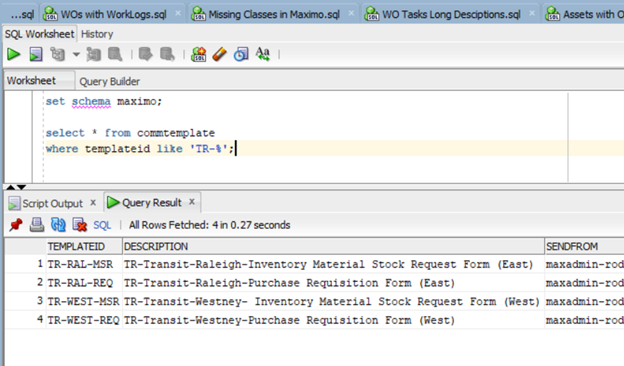

If I run the following SQL against my database, I get the results I am looking for:

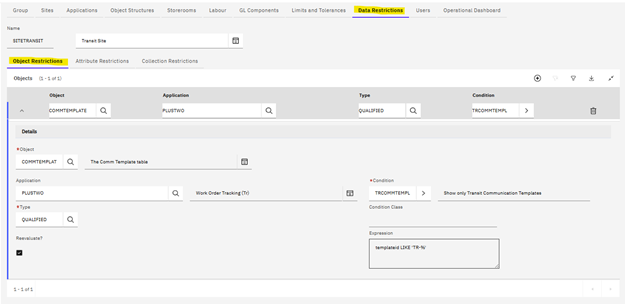

Hi Christi and Isak,
Thanks for responding.  I actually found an Out of the Box way to do this, where no coding was required.  This may not work for all cases, but in this instance it does work since all of the affected users are in a common security group.
Filter the Communication Template list so that only those applicable to Transit show, for only Transit users.

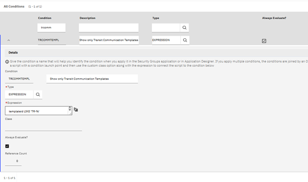

1.      Create Condition
a.      Go to Conditional Expression Manager
b.      Add a new condition:
                                                              i.      Condition:  TRCOMMTEMPL – Show only Transit Communication Templates
                                                             ii.      Type:  EXPRESSION
                                                           iii.      Expression:  templateid LIKE 'TR-%' and templateid not like '%-REQ'
2.      Create Security Restriction:
a.      Go to Security Groups application
b.      Select the “SITETRANSIT” security group
c.      Go to “Data Restriction – Object Resrictions”
d.      Add new Object Restriction
                                                              i.      Object:  COMMTEMPLATE
                                                             ii.      Application:  PLUSTWO
                                                           iii.      Type:  QUALIFIED
                                                           iv.      Condition:  TRCOMMTEMPL

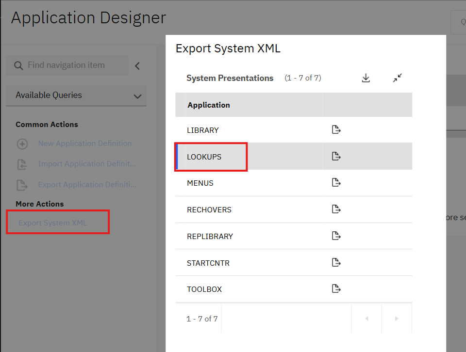

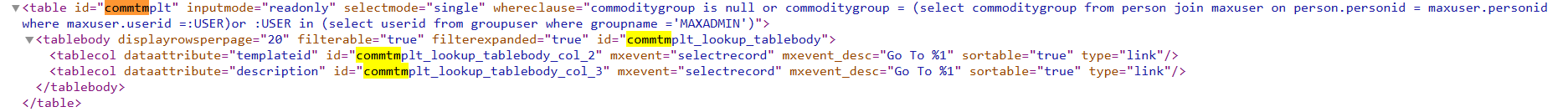

If you want to ALWAYS filter the Lookup for communication templates, instead of using an automation script you could just add a whereclause to the lookup in the XML.  Below is an example of how we are using the whereclause to filter the list based on the person's commoditygroup, but you could also just do something simple like whereclause="templateid like 'TR-%"
You can find this table in the LOOKUP System XML:
